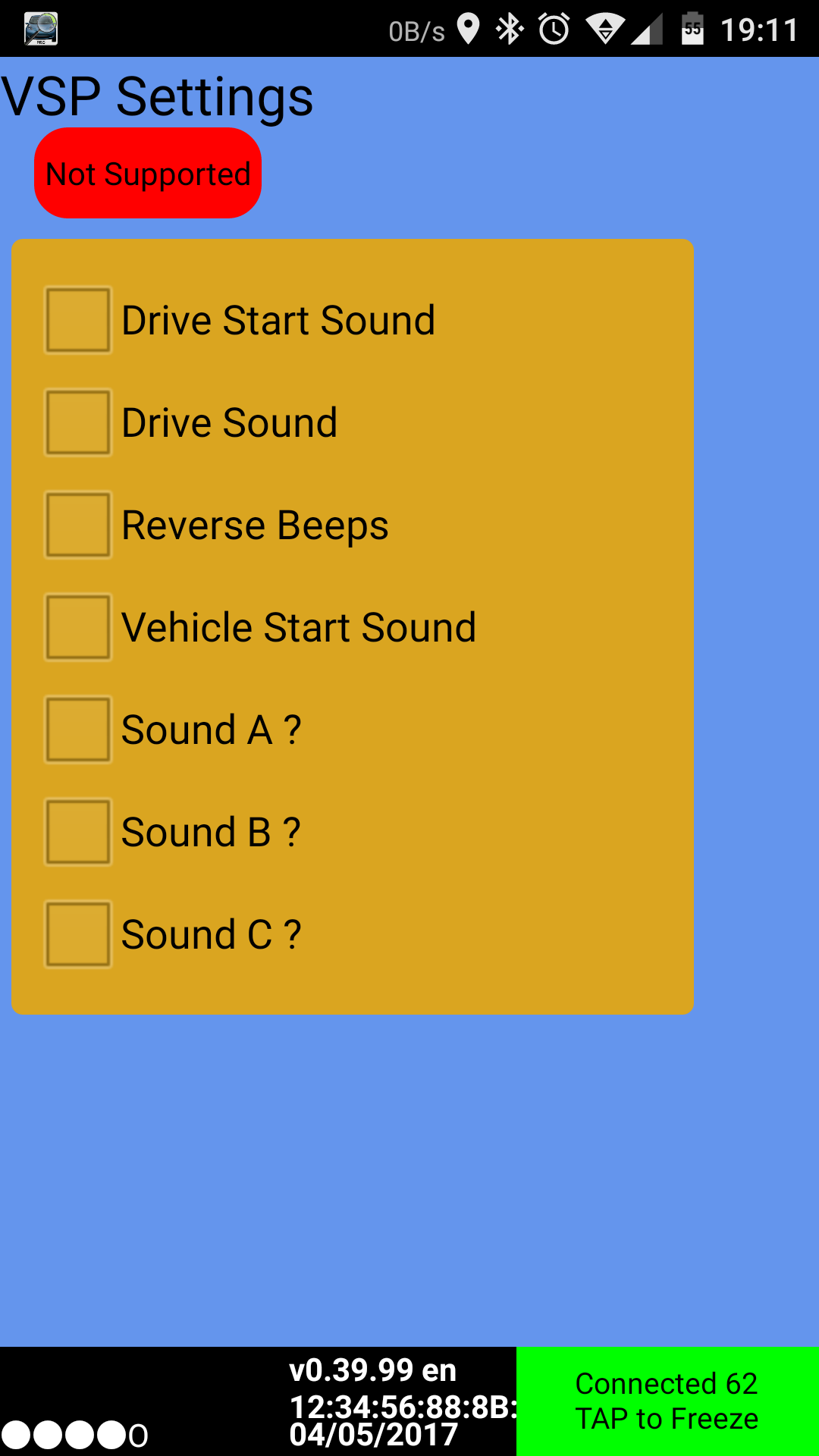

Re: disable VSP sound by software
No meu mk1:
